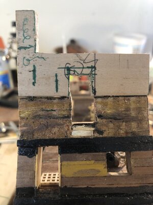

Sorry I have been remiss in updatjng this BL. Since my last entry earlier this month, I have had to do a lot of demo and reconstruction both inside and outside the hull. Not only is the hull not long enough as it is with other kits, it is too short. The height between the upper gun deck and quarterdeck, if built following the plans would be about 4' if I am figuring it correctly. I'm glad I built the full ship (Mamoli) and can use it as a ready reference. The cut out is for the gun port. Main mast will be just left of it and in line with the port and starboard entries. Replanking inside and out will cover the opening to put the gun port in the proper position vertically and fore and aft. The top of the extension (upper left). Painting of the bands will continue after the planking is done.hull extension.jpgis the level of the quarterdeck.
