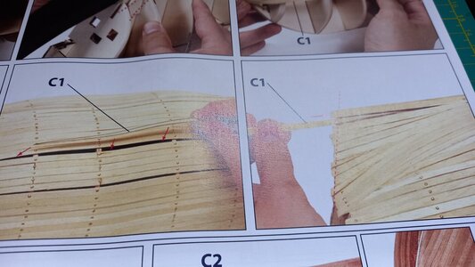

Typical hull planking strips (2nd layer) are 5mm wide and 0.6mm thick. These bend readily in one plane but any attempt to bend them 'sideways' results in kinks or breakage. When laid on a boat hull and allowed to follow their natural bend they tend to turn up and converge at the bow. Many tracts and video clips offer solutions to this problem. The principal ones seem to be:
1: spread out the planks round the fatter bulkheads and fill the gaps with shaped pieces - usually pointed at the ends.
2: on the upper part of the hull taper the planks and allow them to run from stem to stern. On the lower part use shorter planks that are allowed to turn up and are truncated where they meet the upper planks.
Token examples of these methods are illustrated below with extracts from OcCre kit instructions
