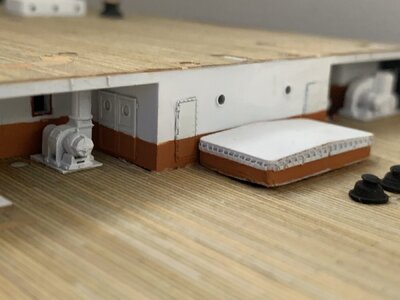

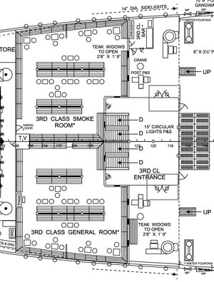

Hi Bob,
I'm working this build as well, and have the KA upgrades. The parts D21/22 you refer to are PE pieces which more accurately position the double doors which enter into the 3rd class smoking area. See the attached pictures. The area marked by the grey squares on the deck plan is the location of those doors.
If you look at Page 13, bottom left corner, you'll see parts B15 and B20 provide the photo etch doors themselves.
Hope this helps you out.

Thank you! So are d21 and d22 not permanent, but just a template to position b15 and b20, and then d21 and d22 are discarded?
Hi. From memory, I actually used the parts on the model and didn't consider them templates.
