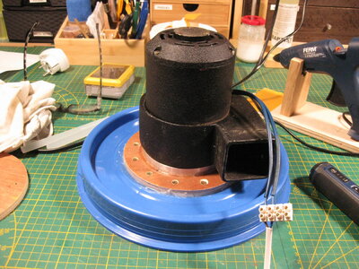

I still had a small industrial fan lying around and on Markplaats I found a small barrel with lid for 7 euros in a village down the road. Ordered a few things from Aliexpres (they have yet to arrive) and got some at the local hardware store. Total spent 41 Euro.

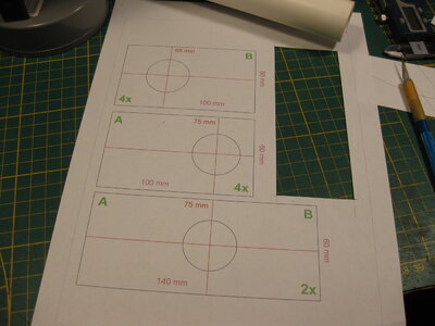

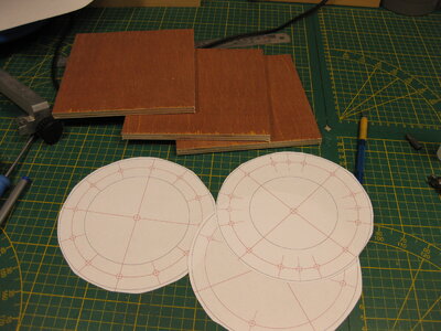

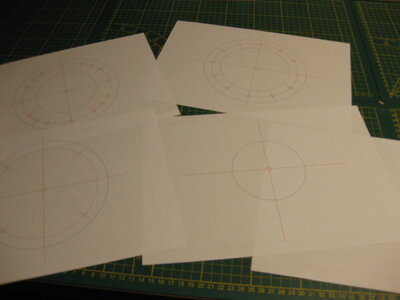

First I made a design of how I attach the motor to the lid, measured a bit and then made a printable drawing.

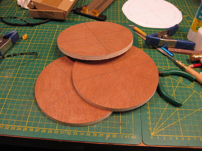

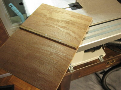

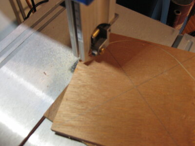

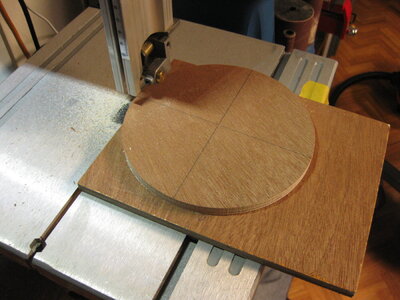

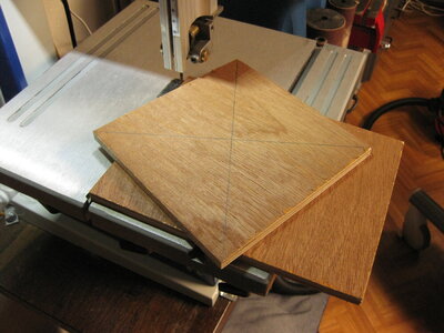

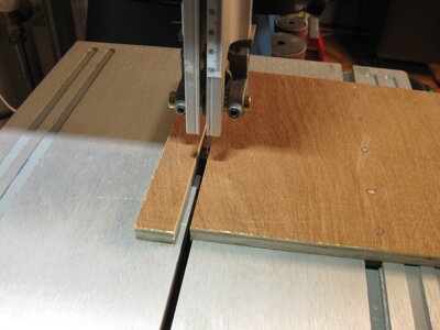

I need to cut these circles out of the wood, for which I made a jig for the bandsaw. I don't think this one needs any explanation otherwise this is a nice video of how it works.
Mine looks like this, just a nail in the plate to turn the wood around

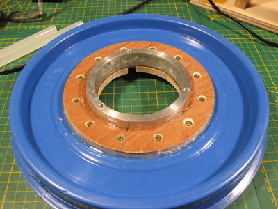

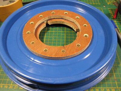

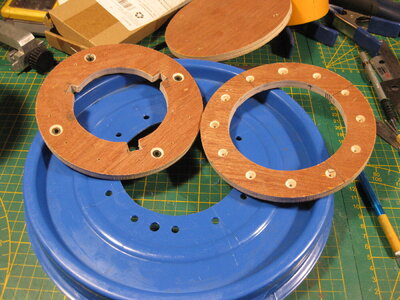

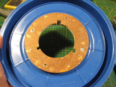

After that I forgot to take a few photo's from the proces to the next stage. But it was nothing else then gluing the paper cutouts on the wooden circles and cut out the middle and drill some holes. I put everything together and use some hot glue to seal it.

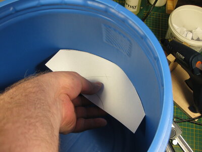

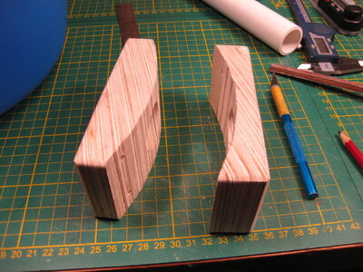

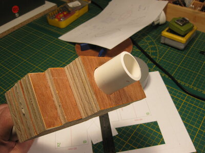

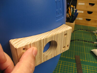

The next thing was to make a inlet on the side of the barrel.
First measuring the circle

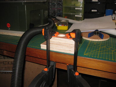

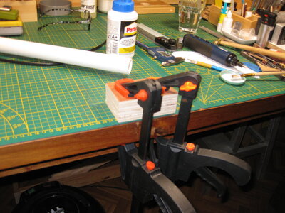

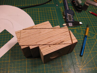

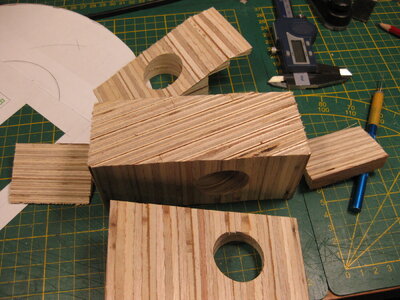

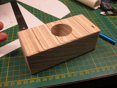

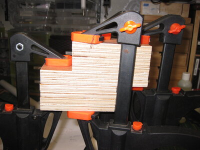

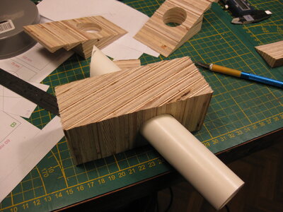

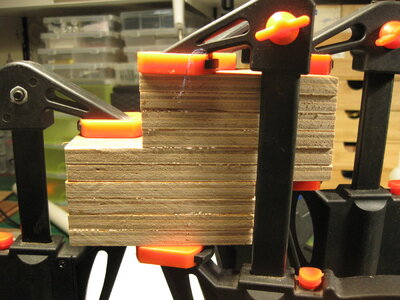

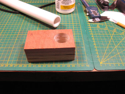

Then make a inlet. I did this by gluing 10 pieces of wood with a hole together
IMG_3672.JPGIMG_3673.JPGIMG_3674.JPGIMG_3675.JPGIMG_3676.JPGIMG_3677.JPGIMG_3678.JPGIMG_3679.JPGIMG_3680.JPG
See next post

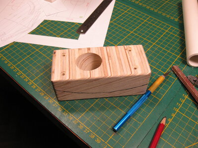

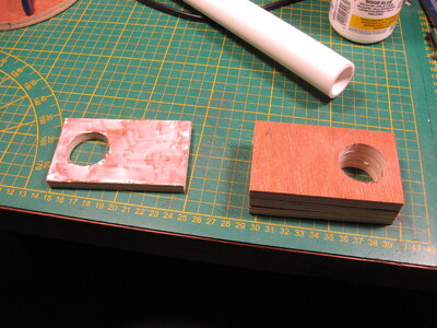

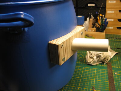

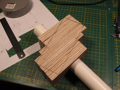

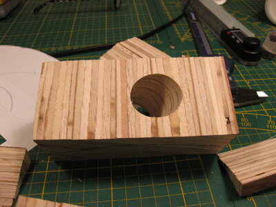

Then I cut out a square
Sanding it and drill 4 holes for the screws.
Then I cut the part in 2 by the rounding of the barrel. And attach it to the barrel. Before that I cut out the holles in the barrel, sorry I forgot to take photo's of that.

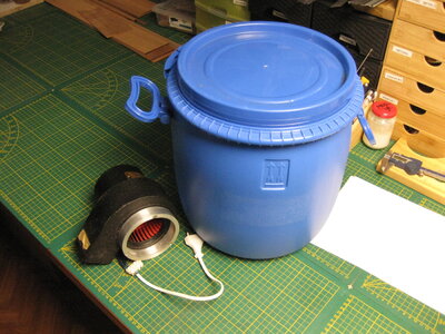

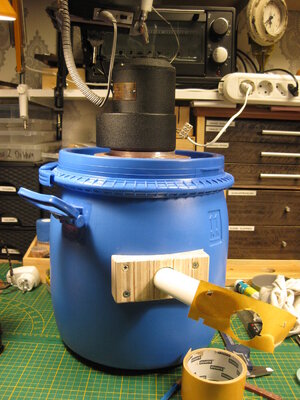

This is how it looks now and you see the suction on the paper on the inlet.
When the hose and filter arrive of Aliexpress I show you the end result.

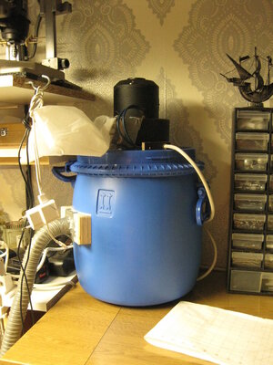

My dust sucking machine is ready. Perfect? yes except the suction power of the motor I used. I use a centrifugal fan, I can change it to a tube fan what is used for bath rooms
sample:
ruck-buisventilator-260m-h-o-100-mm-plus-elektronische-traploze-regelaar-1-0-a.jpgsenp-tdm-inschuif_2.png

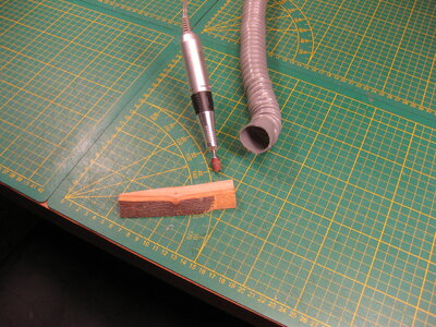

But it does the job where I make it for. The little dust I make when sanding tiny parts like the frames of the ship or the ornaments. Fore that it's perfect. No more dust.
The machine stands next to my desk and is always available when needed.

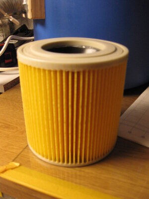

I use a dust bin on the outlet. I wanted to use a filter in the inside but lost to much suction power
Maybe when I change the motor in the future for a more powerful and another fan type. But for this moment it works, and all the dust keeps in the barrel, the filter on the outlet is for the invisible dust that comes out.
Thanks for the visit.
