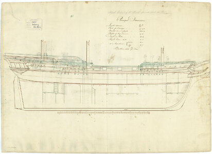

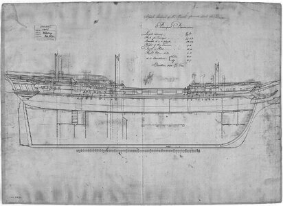

Her's an original drawing of the Discovery1789. The beams almost line up but not all of them. Some are moved for stuff. There are more beams on the upper deck because it is also the gun deck. Black and white drawing is just a little clearer.
Brilliant Don. I have that longitudinal drawing of various swan class ships and never thought to use them! My thanks!

It appears to me that the vast majority are in line with each other. If you want to get another source, Seawatch books now has a set of plans for the books you have for $45 USD. I'm going to order a set since I have the books. :) Although the description does say it's only 2 sheets, so it may not have the information you wish.
